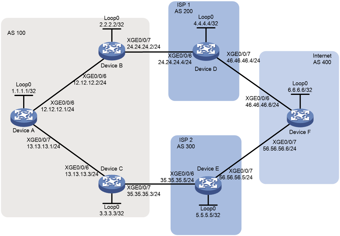

As shown in Figure 1, all devices run BGP. Two paths can be used for communication between AS 100 and AS 400. Path Device A > Device B > Device D > Device F passes through AS 200, and path Device A > Device C > Device E > Device F passes through AS 300. Configure a routing policy on Device B and Device C separately to meet the following requirements:
· Traffic from AS 100 to AS 200 is preferentially forwarded by Device D.
· Traffic from AS 100 to AS 300 is preferentially forwarded by Device E.
· Traffic from AS 100 to AS 400 is preferentially forwarded by Device D.

# Configure an IP address for GigabitEthernet 1/0/1 on Device A.
<DeviceA> system-view
[DeviceA-GigabitEthernet1/0/1] ip address 12.12.12.1 24
[DeviceA-GigabitEthernet1/0/1] quit
# Configure IP addresses for other interfaces as shown in Figure 1. (Details not shown.)
Configuring BGP connections
# On Device A, enable the default BGP instance, set the AS number to 100, and specify 12.12.12.2 and 13.13.13.3 as BGP peers.
[DeviceA] bgp 100
[DeviceA-bgp] router-id 1.1.1.1
[DeviceA-bgp] peer 12.12.12.2 as-number 100
[DeviceA-bgp] peer 13.13.13.3 as-number 100
[DeviceA-bgp] address-family ipv4 unicast
[DeviceA-bgp-ipv4] peer 12.12.12.2 enable
[DeviceA-bgp-ipv4] peer 13.13.13.3 enable
[DeviceA-bgp-ipv4] quit
[DeviceA-bgp] quit
# On Device B, enable the default BGP instance, set the AS number to 100, specify 12.12.12.1 and 24.24.24.4 as BGP peers, and redistribute direct routes.
[DeviceB] bgp 100
[DeviceB-bgp] router-id 2.2.2.2
[DeviceB-bgp] peer 12.12.12.1 as-number 100
[DeviceB-bgp] peer 24.24.24.4 as-number 200
[DeviceB-bgp] address-family ipv4 unicast
[DeviceB-bgp-ipv4] peer 12.12.12.1 enable
[DeviceB-bgp-ipv4] peer 24.24.24.4 enable
[DeviceB-bgp-ipv4] import-route direct
[DeviceB-bgp-ipv4] quit
[DeviceB-bgp] quit
# On Device C, enable the default BGP instance, set the AS number to 100, specify 13.13.13.1 and 35.35.35.5 as BGP peers, and redistribute direct routes.
[DeviceC] bgp 100
[DeviceC-bgp] router-id 3.3.3.3
[DeviceC-bgp] peer 13.13.13.1 as-number 100
[DeviceC-bgp] peer 35.35.35.5 as-number 300
[DeviceC-bgp] address-family ipv4 unicast
[DeviceC-bgp-ipv4] peer 13.13.13.1 enable
[DeviceC-bgp-ipv4] peer 35.35.35.5 enable
[DeviceC-bgp-ipv4] import-route direct
[DeviceC-bgp-ipv4] quit
[DeviceC-bgp] quit
# On Device D, enable the default BGP instance, set the AS number to 200, specify 24.24.24.2 and 46.46.46.6 as BGP peers, and advertise the route 4.4.4.4/32.
[DeviceD] bgp 200
[DeviceD-bgp] router-id 4.4.4.4
[DeviceD-bgp] peer 24.24.24.2 as-number 100
[DeviceD-bgp] peer 46.46.46.6 as-number 400
[DeviceD-bgp] address-family ipv4 unicast
[DeviceD-bgp-ipv4] peer 24.24.24.2 enable
[DeviceD-bgp-ipv4] peer 46.46.46.6 enable
[DeviceD-bgp-ipv4] network 4.4.4.4 32
[DeviceD-bgp-ipv4] quit
[DeviceD-bgp] quit
# On Device E, enable the default BGP instance, set the AS number to 300, specify 35.35.35.3 and 56.56.56.6 as BGP peers, and advertise the route 5.5.5.5/32.
[DeviceE] bgp 300
[DeviceE-bgp] router-id 5.5.5.5
[DeviceE-bgp] peer 35.35.35.3 as-number 100
[DeviceE-bgp] peer 56.56.56.6 as-number 400
[DeviceE-bgp] address-family ipv4 unicast
[DeviceE-bgp-ipv4] peer 35.35.35.3 enable
[DeviceE-bgp-ipv4] peer 56.56.56.6 enable
[DeviceE-bgp-ipv4] network 5.5.5.5 32
[DeviceE-bgp-ipv4] quit
[DeviceE-bgp] quit
# On Device F, enable the default BGP instance, set the AS number to 400, specify 46.46.46.4 and 56.56.56.5 as BGP peers, and advertise the route 6.6.6.6/32.
[DeviceF] bgp 400
[DeviceF-bgp] router-id 6.6.6.6
[DeviceF-bgp] peer 46.46.46.4 as-number 200
[DeviceF-bgp] peer 56.56.56.5 as-number 300
[DeviceF-bgp] address-family ipv4 unicast
[DeviceF-bgp-ipv4] peer 46.46.46.4 enable
[DeviceF-bgp-ipv4] peer 56.56.56.5 enable
[DeviceF-bgp-ipv4] network 6.6.6.6 32
[DeviceF-bgp-ipv4] quit
[DeviceF-bgp] quit

* >i 4.4.4.4/32 24.24.24.4 0 300 0 200i
* >i 5.5.5.5/32 35.35.35.5 0 200 0 300i
* >i 6.6.6.6/32 24.24.24.4 300 0 200 400i
* >i 12.12.12.0/24 12.12.12.2 0 100 0 ?
* >i 13.13.13.0/24 13.13.13.3 0 100 0 ?
* >i 24.24.24.0/24 12.12.12.2 0 100 0 ?
* >i 35.35.35.0/24 13.13.13.3 0 100 0 ?
# Verify that packets from Device A to 6.6.6.6 are forwarded by Device D.
[DeviceA] tracert 6.6.6.6
traceroute to 6.6.6.6 (6.6.6.6), 30 hops at most, 52 bytes each packet, press CT
RL_C to break
1 12.12.12.2 (12.12.12.2) 2.417 ms 1.887 ms 1.773 ms
2 24.24.24.4 (24.24.24.4) 4.057 ms 2.293 ms 2.739 ms
3 6.6.6.6 (6.6.6.6) 5.145 ms 4.205 ms 4.402 ms

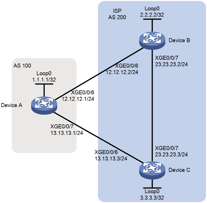

Example: Configuring route selection based on the MED attribute
As shown in Figure 2, all devices run BGP. EBGP runs between Device A and Device B, and between Device A and Device C. IBGP runs between Device B and Device C.
Configure a routing policy to ensure that traffic from AS 100 to AS 200 is preferentially forwarded by Device C. Before you configure the routing policy, the traffic is preferentially forwarded by Device B, because Device B has a smaller router ID than Device C.
Analysis
To ensure that the traffic is preferentially forwarded by Device C, configure a routing policy on Device B to change the MED value for the route to Device A. Make sure the MED value is not the default MED value 0.

Configuring basic BGP
# Configure IP addresses for other interfaces as shown in Figure 2. (Details not shown.)
[DeviceA] bgp 100
[DeviceA-bgp] peer 12.12.12.2 as-number 200
[DeviceA-bgp] peer 13.13.13.3 as-number 200
[DeviceA-bgp] quit
# On Device B, enable the default BGP instance, set the AS number to 200, and specify 12.12.12.1 and 3.3.3.3 as BGP peers.
[DeviceB] bgp 200
[DeviceB-bgp] peer 3.3.3.3 as-number 200
[DeviceB-bgp] peer 3.3.3.3 connect-interface LoopBack0
[DeviceB-bgp-ipv4] peer 3.3.3.3 enable
[DeviceB-bgp-ipv4] network 23.23.23.0 24
[DeviceB-bgp] quit
# Configure a static route to 3.3.3.3/32 on Device B.
[DeviceB] ip route-static 3.3.3.3 32 23.23.23.3
# On Device C, enable the default BGP instance, set the AS number to 200, and specify 13.13.13.1 and 2.2.2.2 as BGP peers.
[DeviceC] bgp 200
[DeviceC-bgp] peer 2.2.2.2 as-number 200
[DeviceC-bgp] peer 2.2.2.2 connect-interface LoopBack0
[DeviceC-bgp-ipv4] peer 2.2.2.2 enable
[DeviceC-bgp-ipv4] network 23.23.23.0 24
[DeviceC-bgp] quit
# Configure a static route to 2.2.2.2/32 on Device C.
[DeviceC] ip route-static 2.2.2.2 32 23.23.23.2
# Display the BGP routing table on Device A. The output shows that the route with the next hop 12.12.12.2 becomes the optimal route to network 23.23.23.0/24.
[DeviceA] display bgp routing-table ipv4
Total number of routes: 2
BGP local router ID is 1.1.1.1
Status codes: * - valid, > - best, d - dampened, h - history,
s - suppressed, S - stale, i - internal, e - external
Origin: i - IGP, e - EGP, ? – incomplete
Network NextHop MED LocPrf PrefVal Path/Ogn
* >e 23.23.23.0/24 12.12.12.2 0 0 200i
* e 13.13.13.3 0 0 200i
Configuring a routing policy
# Create routing policy 10 on Device B and set the cost to 100.
[DeviceB] route-policy 10 permit node 10
[DeviceB-route-policy-10-10] apply cost 100
[DeviceB-route-policy-10-10] quit
# Apply routing policy 10 to routes to peer 12.12.12.1.
[DeviceB] bgp 200
[DeviceB-bgp-ipv4] peer 12.12.12.1 route-policy 10 export
[DeviceB-bgp] quit
# Display the BGP routing table on Device A. The output shows that the MED value for the route with next hop 12.12.12.2 changes to 100, and the route with next hop 13.13.13.3 becomes the optimal route.
* >e 23.23.23.0/24 13.13.13.3 0 0 200i
* e 12.12.12.2 100 0 200i
